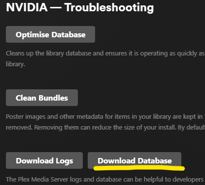

There is this Download DB option, so I’d expect a an easy way to restore a backup. Am I misunderstanding the purpose of this function?
Any other system has an easy and simple way to backup and restore, yet it seems with PMS it’s quite a convoluted process, why can’t there be a one click backup and restore function included, maybe something to consider for future builds?
Otherwise it means setting it up from scratch each time, which is laborious and quite a PITA!
It’s the exact same way as restoring any server install on any thing a the server can run on. The difference with shield is by default the PMS folder which contains the DB is not in user accessible storage. You need to move it first which is outlined how to do in link below and the step three of that users directions. https://support.plex.tv/articles/moving-server-data-storage-location-on-nvidia-shield/
