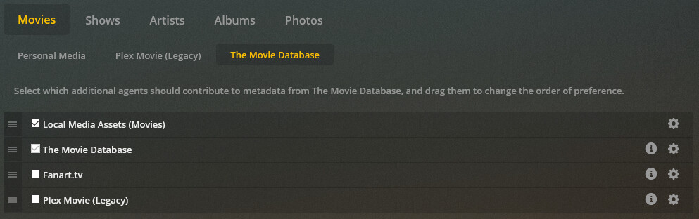

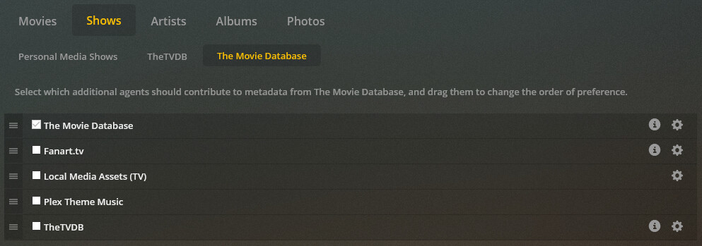

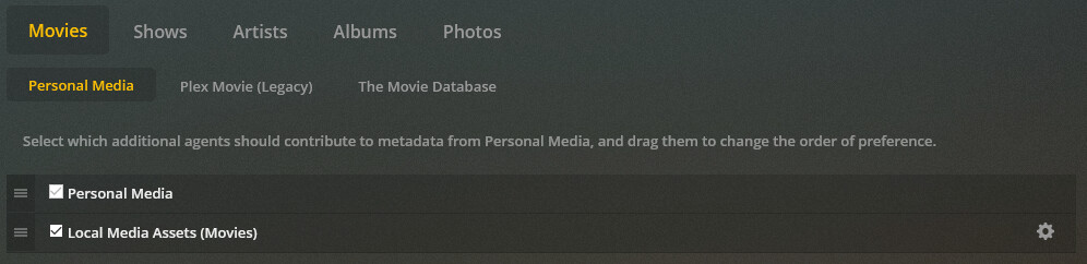

2 remaining questions however:
1/ Can you just point out the agents that create simlinks? (to avoid them)
Here is the list to make it easier for you to just add if they create simlinks of not.
Agents highlighted in red are the ones we can select in Library > Edit… > Advanced > Agent
The other ones are only visible on the Settings > Agents page.
  • Movies > Plex Movie - no simlinks
  • Movies > Plex Movie (Legacy) - simlinks
  • Movies > Personal Media - no simlinks???
  • Movies > The Movie Database
  • Movies > CineMaterial
  • Movies > Fanart.tv
  • Movies > Local Media Assets (Movies)
  • Movies > OpenSubtitles.org
  • Shows > Plex TV Series (BETA) - no simlinks
  • Shows > TheTVDB - simlinks???
  • Shows > Personal Media Shows
  • Shows > The Movie Database
  • Shows > Fanart.tv
  • Shows > Local Media Assets (TV)
  • Shows > Plex Theme Music
  • Shows > OpenSubtitles.org
  • Artists > Plex Music - simlinks???
  • Artists > Personal Media Artists
  • Artists > Last.fm
  • Artists > Fanart.tv
  • Artists > Home Theater Backdrops
  • Artists > Local Media Assets (Artists)
  • Albums > Personal Media Albums
  • Albums > Fanart.tv
  • Albums > Last.fm
  • Albums > LyricFind
  • Albums > Local Media Assets (Albums)

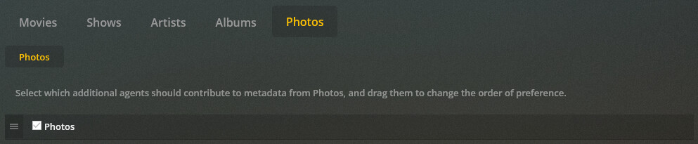

  • Photos > Photos - no simlinks???
2/ How does the Settings > Agents page work?
As this page is really not up-to-date. All new agents are not displayed, some like Plex Music are also not listed and some old can not even be unticked (like Plex Movie (Legacy) or TheTVDB). Even with the last PMS version (1.22.1.4228), after upgrading to 2 new agents, all my settings on the Agents page remain unchanged, the exact same as in my post above.
