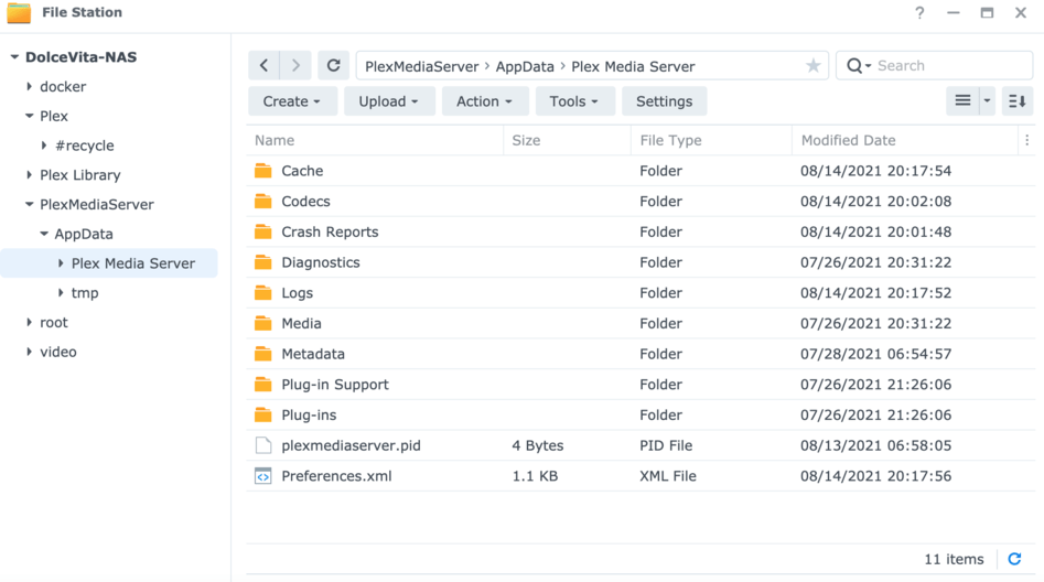

  1. Create Plex shared folder
  2. Create Plex: Library / Application Support / Plex Media Server (the familiar structure)
  3. In “Plex Media Server” folder, you place all the normal contents —
bash-4.4#
bash-4.4# pwd
/volume2/Plex/Library/Application Support/Plex Media Server
bash-4.4# ls
 Cache	 'Crash Reports'   Logs    Metadata  'Plug-in Support'	 Profiles
 Codecs   Diagnostics	   Media   Plug-ins   Preferences.xml
bash-4.4#

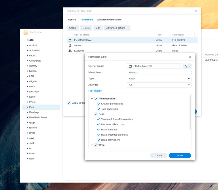

Now for the most important step.
  1. If DSM 7 PlexMediaServer was previously installed, the Sysatem Internal User “PlexMediaServer” will already exist. We can use this to take a shortcut.
  2. Open File Station
  3. Right Click the “Plex” share → Properties → Permission → CREATE button
  4. Select the “PlexMediaServer” internal user (you need scroll down to find it)
  5. Make certain it has all Administrative, Read, and Write permissions
  6. You also Apply to “This folder, sub-folders, and files”
7. Depending on the amount of metadata – this will take an proportional amount of time.
8. When done, you are ready to install PMS for DSM 7
