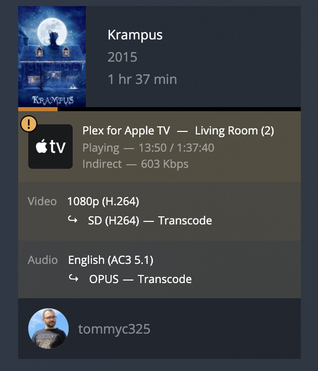

Is that “bad quality” stream of yours showing as local, remote or indirect on the server’s dashboard (now playing)?
Exemplary screenshot from the "now playing" section

Indirect
That implies the two devices are on different subnets and cannot see themselves directly. This can happen if they’re connected to different active network components (e.g. access points / routers) which create their own subnets. Some routers create different subnets for wired vs. wireless connections or regular vs. guest network.
With that, Plex will consider the connection to be remote… if there’s some trouble with the remote access configuration, this will result in an indirect / relayed connection. Relayed connections are only offering a limited bandwidth.
