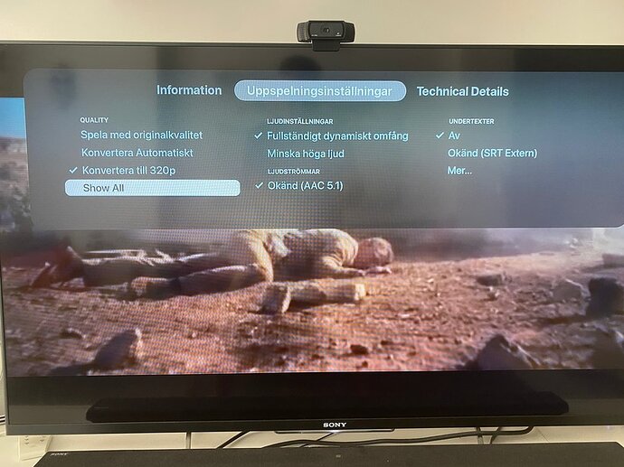

  2. Whatever I choose here it goes back to convert to 320p automatically???

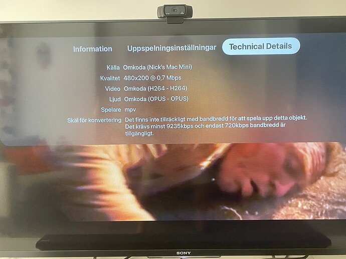

  3. Just a screenshot of the Technical Details.

It says “There is not enough bandwidth to play this item” as you can see on the image above under Technical Details, but still I have 175 Mbps…
so this must be why - I have like 3 meters between the TV and my Mac mini.

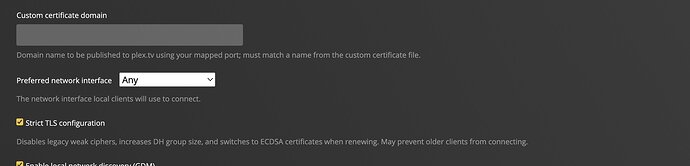

I believe your issue is the preferred interface, change to any and use a Split Tunnel Vpn with app exceptions that supports your OS
