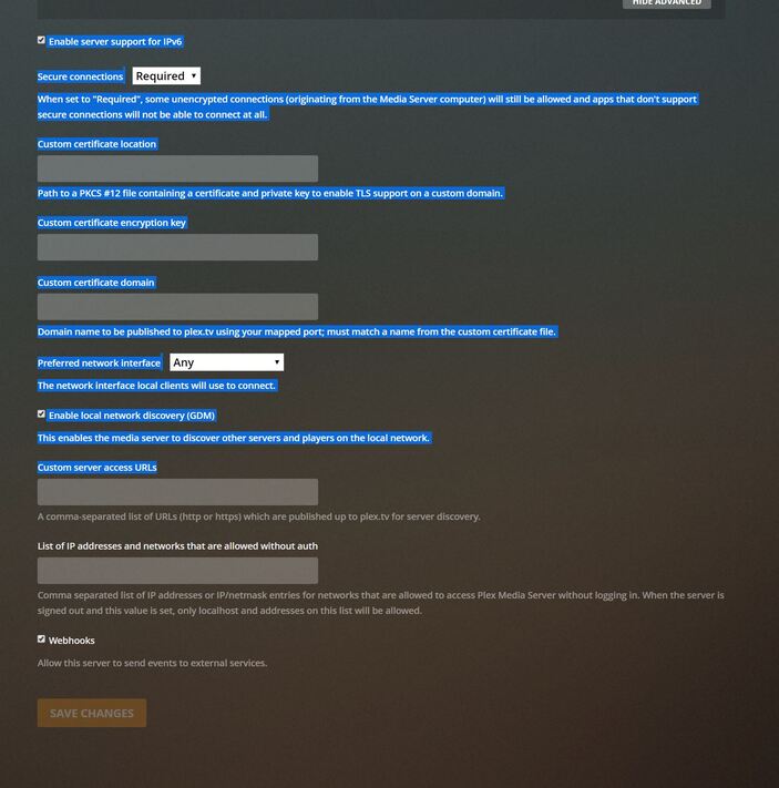

Go into plex, go to Settings>Network
Make sure everything looks like this:

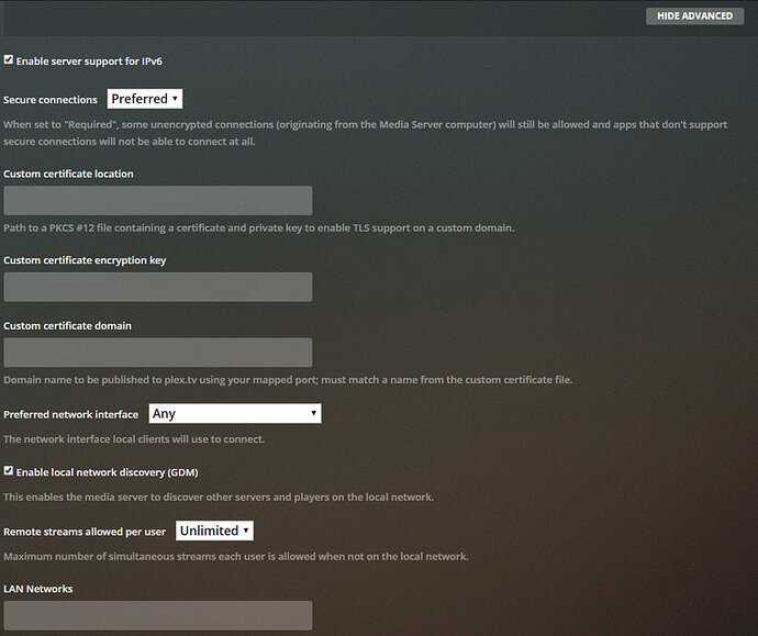

well it looks like that but I dont have a few options that you have heres a screenshot
for now switch required to preferred and see if you can connect…
yea that worked any chance you can help me out with the secured connection issue i have tried switching the dns ip4v protocal and ip6v protocol to google but still no luck
