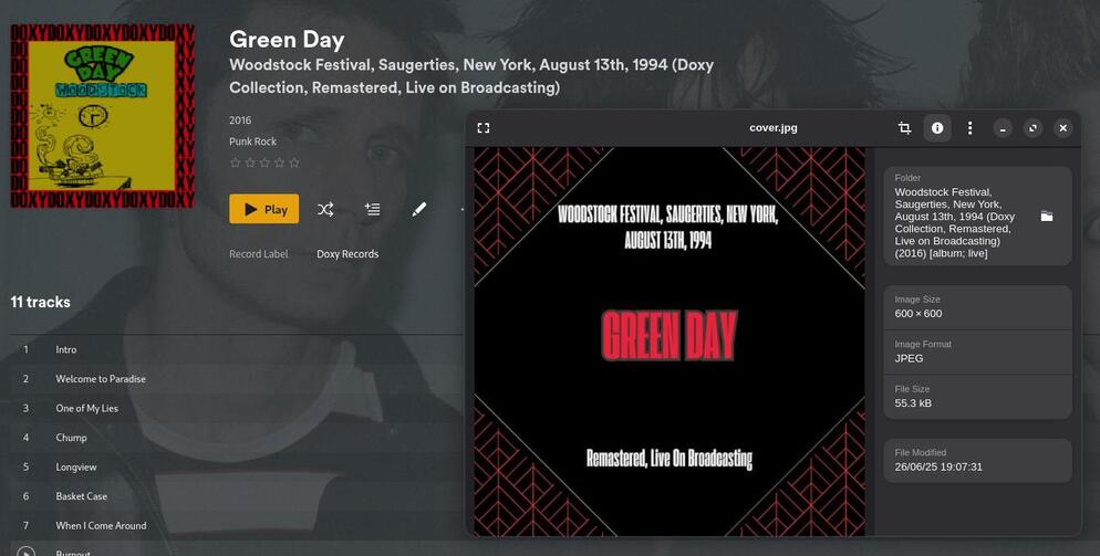

I’ll add a visual. Here is album Release “Woodstock Festival, Saugerties, New York, August 13th, 1994 (Doxy Collection, Remastered, Live on Broadcasting)” by Green Day - MusicBrainz in plex with build 1.41.9.9912
You can see in the screenshot plex has one type of album artwork and the cover.jpg for this album within my folder is shown on the right.
Now, downgrade to 1.41.8.9834 and without changing anything other than a album refresh it changes, correctly, to my album artwork.

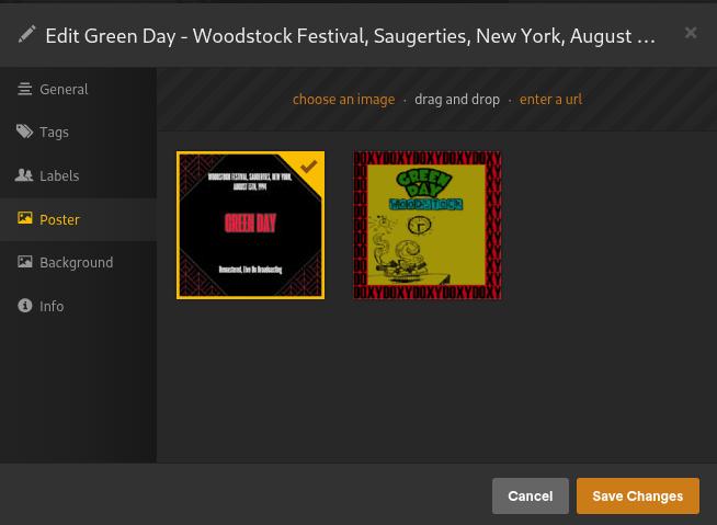

I’ll also add, that if I edit this album with build 1.41.8.9834 I see both my album art and the one from plex, however with build 1.41.9.9912 only the plex one is visible.
