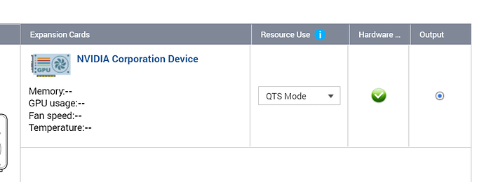

When you go to the Control Panel -> Hardware -> Graphics Adapter,
Is it in QTS mode ?
yes but for some reason doesn’t show model or any info it would normally…
If it’s not showing the info then you need to have QNAP look.
