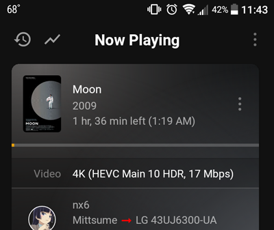

It already does.
Screenshot_20200904-234344-crop
