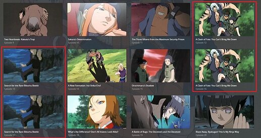

I have episodes that are incorrectly identified. A show that I have completely watched had unwatched episodes all of a sudden.
I have not gone through my entire library to find how often this has occurred but I will give an example.
Show: Naruto
Season 4 (aired order)
Episodes 12 and 13 are showing information related to 16 and 17 respectively.
I went to the TVDB to check the episode information.
Here is the data that should be used for Season 4 Episode 12 using the aired info:
Here is the data that is used for both Season 4 Episodes 12 and 16. It should only be used for episode 16.
As you can see, this is the same problem for Season 4 episodes 13 and 17.

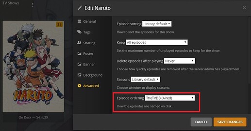

Here is a screenshot of show properties where you can see the episode ordering is set to TheTVDB (Aired).
