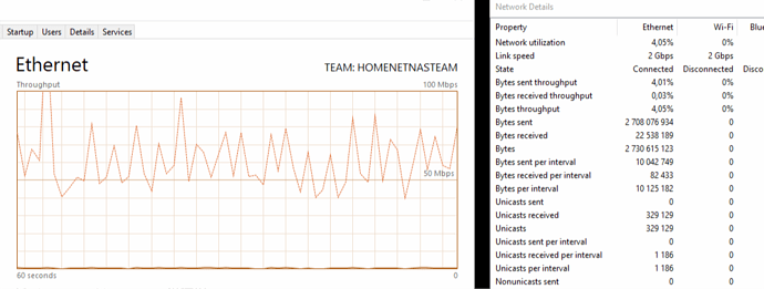

Xbox view from server in the middle of the movie - both AC3/TrueHD:

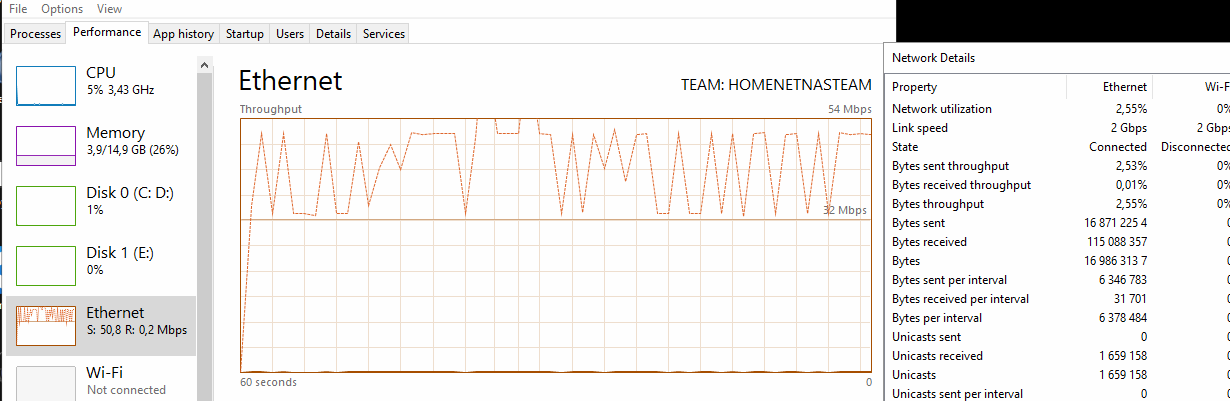

PC view from server (DirectPlay):
You can see that utilization of the server is almost none. Except network and network utilization is very different. If read ahead aggressiveness and buffer is not managed properly then of course we may encounter buffering, right?

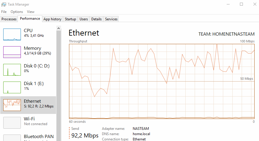

Ok, but what about first several minutes? Here is how it looks like from server side:
AC3 - directplay mode. You may see that Plex sends data very aggressively at first to fill the buffer and later sends chunks of data as it was showed above in the middle of the moview.
Let’s look at TrueHD to AAC conversion now that direct stream. We can see that CPU and memory utilization increased, but not critical. Now plex sends data in chunks right from the start of playback without actually trying aggressive start of filling the buffer.

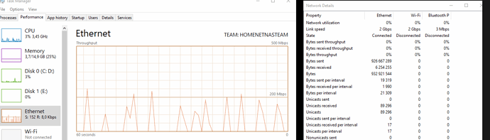

So what about our problematic file? 4K + HDR + AC3 primary in MKV container in DirectPlay mode. Arrow indicates where buffering occurs and after that switch to transcoding happens. Aggressive start but then after several chunks reaching above 500Mbps, problem appears.
