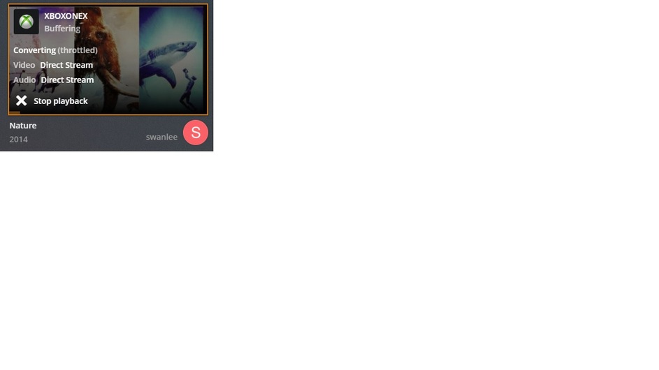

This is getting REALLY frustrating, these buffering issues with 4k HDR content have been going on for almost a year now and the Devs have not given an update as to WTF is oging on? As 4k HDR content become wider used this issue is just getting worse and worse each day
Today on my Xbox one X I tried playing 4 different 4k HDR vides and they all started buffeintrg constantly at 3 mins in. almost like clock work they play fine and after 3 mins buffering buffering buffering. My Xbox is fine my streaming system is fine, my disk array’s are fine this is a continual issue with Plex and Xbox where the 4k stream goes into some trascoding loop and buffers forever.
The audio on these videos were a range of 5.1, 7.1 and stereo audio so the only consisten thing was 4k HDR mkv.

I’m showing direct play when it buffers at the 3 min mark of pretty much all my 4k HDR videos
Direct Stream, and Direct Play are a little different. I believe with Direct Stream that although the actual data is compatible, it is not in a compatible container. This causes a data extraction, which could introduce complications.

So I’ve isolated the issue to the audio codec being used, found some reddit posts and use this command using ffmpeg to strip out the audio and replace it with AC3 and got it to play past 3 mins
ffmpeg -i input.mkv -c: copy -c:a ac3 -b:a 640k output.mkv
This REALLY sucks going to take me weeks to recode all the 4k HDR video I have, WTF Plex and MS really need to get this fixed. Audio codec bug between Plex and Xbox
