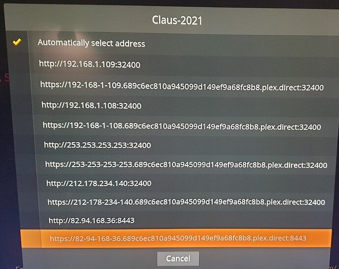

Log is full of similar messages:
ERROR - Error issuing curl_easy_perform(handle): 28
ERROR - Unable to find client profile for device; platform=HTML%20TV%20App, platformVersion=3.9.0, device=SmartTV, model=
If it helps, from all available addresses to reach server, from this application only last on the list is working; none of direct ones (:32400) work - only relayed ones do
