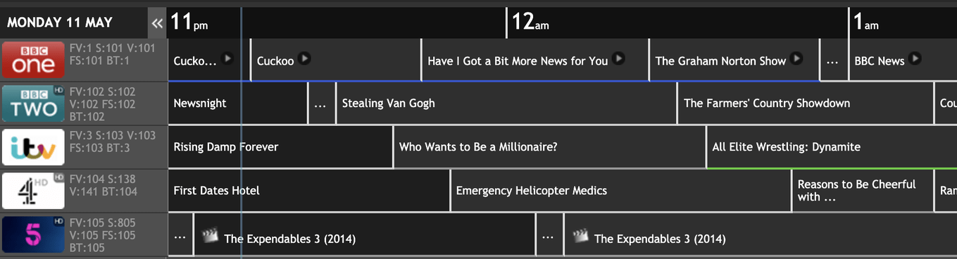

Film for anyone testing a possible fix in the UK (Tonight at 11PM on Five or Five HD): The Expendables 3
Do the guides for these other systems also show the news break in the middle?
Yes they all show the same way, when you set a movie to record both halves show up on the guide as to be recorded, which it looks like Plex is also doing, just it never gets recorded.

For reference you can see the interludes clearly on a regular TV guide: https://www.tvguide.co.uk/
Tends to be on Five, ITV or channels that might be sister channels to these providers, however, it should be the same on any channel.

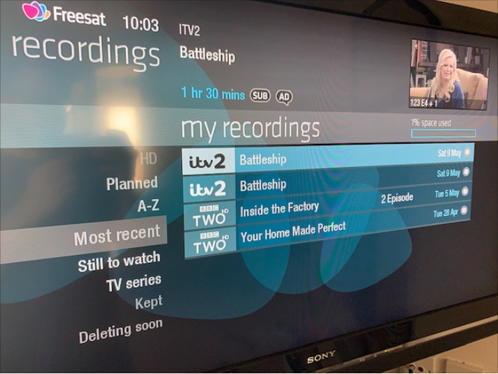

Ok, the results are in:
Virgin Media - TiVO box
Humax Freesat - HDR-1100S
  • Surprising it shows as two recordings
  • So it recorded all instances of the movie like it was a series I guess
  • At least I can still get the complete movie but the experience is not great as you have to navigate to continue watching
Sony TV - Built in DVR running on the aerial tuner
  • Split the recording just recording both parts, strangely it also had a 3rd recording to do with same movie, not sure what thats about.
  • Again experience is messy
Conclusion
Of the set top DVR options I have on hand to test my current main system, the Virgin Media TiVO box, gives the best user experience and I guess the most reliable. Not sure if there are any options on these devices to change the behaviour, these are default settings.
