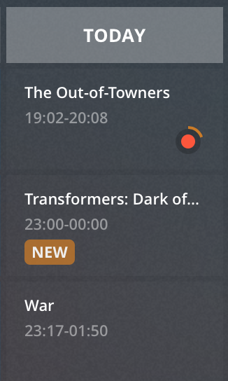

Since the EPG switch, Plex will no longer record movies that have programmes in-between, even though the second part also has a record icon against it. The practice of having a short interlude in the middle of a movie is a common occurrence on many UK channels.
Before the EPG change, Plex used to handle this perfectly but now Plex will only record the first part of the movie so I end up with the first hour of a movie – the scheduled recording also actually shows the movie as only being an hour long. I’ve uploaded a screenshot of an example from the guide.
In this example, the James Bond movie Octopussy has a 60 second show in the middle called FYI Daily. Note how both parts of the movie have record icon against them but only the first is recorded. I won’t even go into how odd the description for the 60 second show is…
How can I get Plex to record both parts of the movie? The only workaround I have is to modify the recording and change the ‘minutes after end’ figure to something like 90 minutes.
[edited to remove duplicate image]
As an addendum, this is what the recordings look like on the schedule. Note that Plex thinks these movies are only approx. an hour long.
