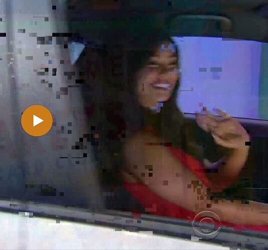

I was trying to get rid of Block noise on one of my channels, which I do not see on my Android phone, but do see on the Shield and Web Client. Maybe a topic for another thread if even a problem with Plex.

Yeah this is another issue, transcoding will just covert the file to h264 (you’re original format is mpeg2).
Do you get the same in liveTV? Is is just this channel? When you say it works on android is that still using the shield as the server?
Yes, Live and recorded only on CBS. It’s over the air local signal. Using the Hdhomerun Signal Meter for Android I get 100% signal strength, SNR quality and Sym Quality, but yet get these blocks on motion like panning left or right.
I have the Samsung S9 phone and when watching CBS Plex Live TV or recorded on this device, I do not see any block noise. This is with using Shield as the server. Maybe all the data is there, but the cell phone app is dropping the bad frames and masking it. Just a thought.
I’m not sure but this might be a HDHomerun issue. Do you have any ideas how I can determine if this is a Plex issue or a HDHomerun issue?
Hum first thing would be to try and stream directly using vlc i.e.
Let me know if you need assistance with that.
Last night I installed VLC and HDHomeRun Setup desktop application on my PC. Clicking on the CBS channel in the HDHomeRun Setup program opens VLC. I still see the Block noise viewing with VLC, so looks to be a HDHomeRun issue or bad compression from the local CBS channel. Do you concur?
Even if the signal is 100%, one other option that I see myself is that even with 100% my spliter seems to have some issue and I get similar effects on 1 or 2 channels (but I acautlly see the same in my bedroom TV connected directly and started after I added the splier, I’m waiting for a new one to see if the issue goes away.
But if you have the option you could try to see if this channel play fine on a TV via the same connection.
In my case If I remove the spliter both the TV or HDHomerun work flawlessly so I’m sure that is the issue.
That said its clearly not an Nvidia PMS issue, since you see the same in VLC.
What kind of tuner are you using? Also please note there is a difference between signal strength and signal quality. It could be that your signal is too strong and could be over driving the tuner which causes the saturation that you’re seeing. If you using an HDHomerun, go to the web interface and note what your signal quality and strength are when it occurs again.
