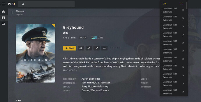

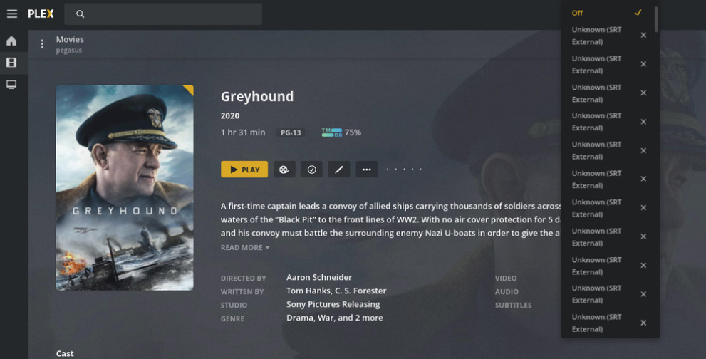

Bunch of `Unknown (SRT External)' junk after updating to new Plex Movie Agent
Server Version#: Version 1.20.0.3125
Player Version#: Version 4.38.2
After upgrade to the new plex movie agent and completing a full refresh I see all this junk under subtitles for EVERY movie in my library which I have checked.
anyone know what is going on here and how to resolve. Don’t remember seeing this before switching to the new agent.

so I know what is happening and will post here in case anyone else runs into this. I have all my movies in a couple of flat folders – see below as an example…
-rw-r–r-- 1 501 mcurran 116822 May 26 16:34 ‘Weathering with You (2019).eng.srt’
-rw-r–r-- 1 501 mcurran 1873705897 May 26 16:44 ‘Weathering with You (2019).mp4’
-rw-r–r-- 1 501 mcurran 1456 Mar 18 2019 ‘Whisper of the Heart (1995).eng.srt’
-rw-r–r-- 1 501 mcurran 2275904597 Dec 17 2019 ‘Whisper of the Heart (1995).mp4’
-rw-r–r-- 1 501 mcurran 5004 Jul 2 16:54 ‘Your Name (2016).eng.srt’
-rw-r–r-- 1 501 mcurran 2177916931 Jul 2 16:55 ‘Your Name (2016).mp4’
as there is then multiple .eng.srt in the library root folder (files named the same as the movie I might add) the new scanner and plex beta version 1.20 does not handle this situation well.
It SHOULD filter and only display the subtitle based on name but instead is showing all the bloody subtitles in the list.
I’ll have to move each movie now within folders with the movie name which I never wanted to do.
Good job plex, you make a new feature and force me to redesign my entire library setup which has worked for years…
