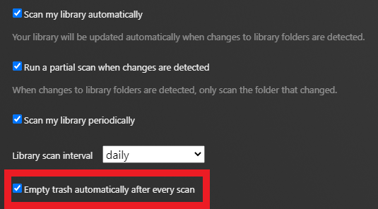

One thing you want to keep in mind is keeping the drive on the mac accessible when the NAS is on. If the NAS server scans your files while the mac is off Plex will think those items have been deleted off your file system
Screenshot (816)
Server –> Library
You have to disable “empty trash automatically after every scan” so all the metadata for the files doesn’t get wiped out
