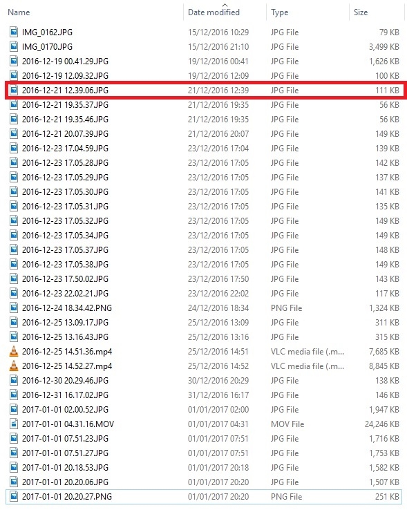

Heres a screenshot of my photos stored within my specified location in the drive including their names and dates if it would help.
(The item highlighted with red is the burst mode (i think) that was activated, while taking the picture, and only one is shown while the other was overwritten).
It is sorted by dates, in “ascending” order.
The “Dates Modified” here are formatted as DD/MM/YYYY hh:mm
