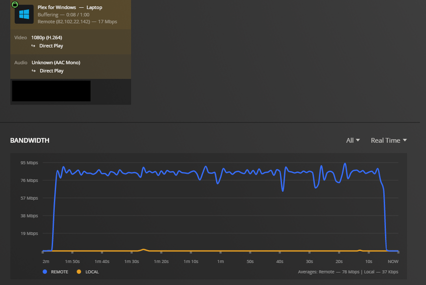

  • Very odd that it’s jumping to almost 100 Mbps speed during that 2 minutes. Was there any other activity going on at that moment?
  • When you play on the web app or ios, can we see a pic of the dashboard here? Those players are often less capable than the Plex-for-Windows app, which might cause a transcode, lowering the file bit-rate and possibly fixing any errors in a file that is direct-played. Let’s see whether it transcodes, and what the file bit-rate becomes at that point.

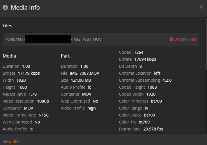

It appears to me that this file is not muxed properly for streaming.
Also, there is no good reason to use the antiquated MOV container with H.264 video.
Experiment:
Get MKVtoolnixGUI
drag the mov file into it
“Start Multiplexing”
Take the resulting mkv file and put it onto your Plex server.
(this procedure won’t change the quality of the file)

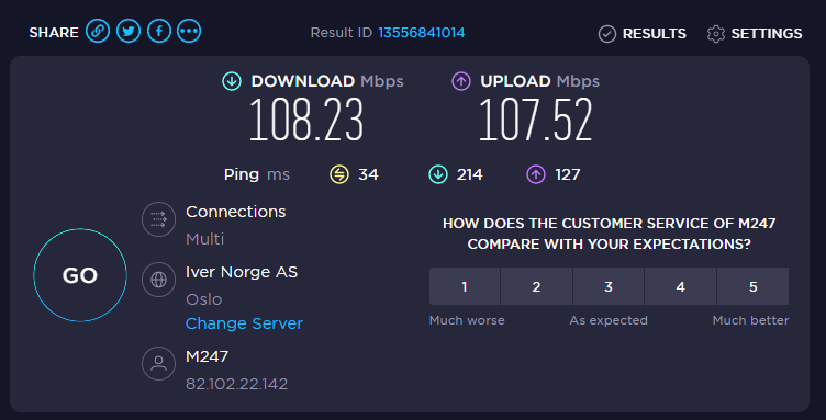

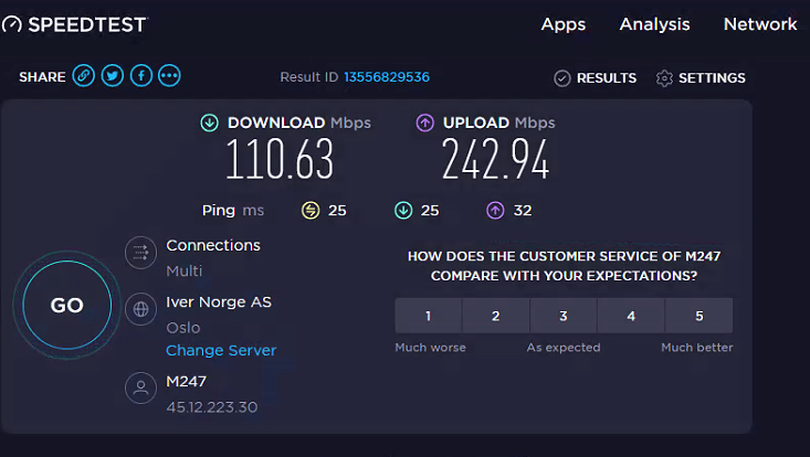

Yes, this is a remote streaming, but I have a fairly decent upload and download speed both at home where the server is and here I am now.
Please see the following Speedtest.net results:
At the server location:
At my current location:
Yes, I also find it very strange that the transfer rate is 100 Mbps for the duration of the movie. Especially since the movie clip itself, as mentioned, is no more than 130 MB in size…
In this photo I stream from the web application and there you can see that the transfer rate is only for a short time. Also this time in Direct.
