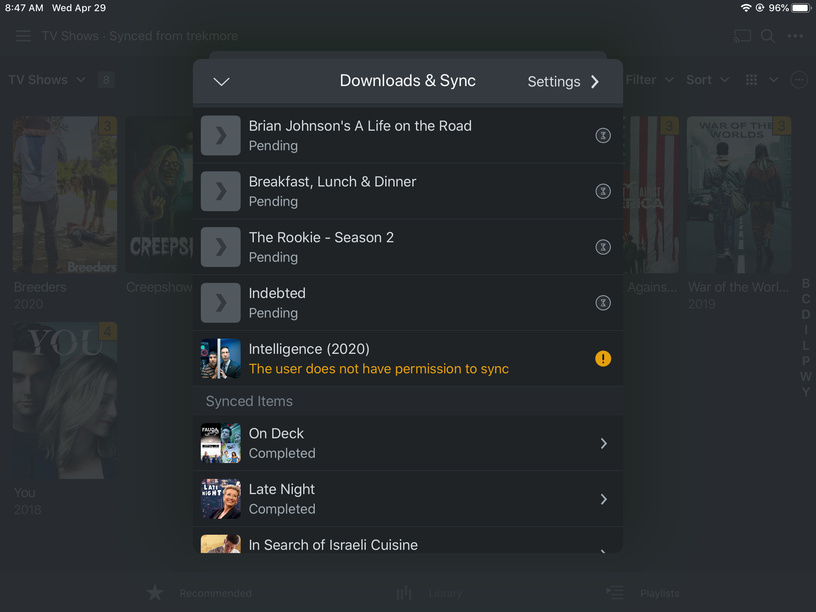

If I setup a sync from a friends shared server via the device IE: iPad for example a TV show, it will sync fine.
But I I use my local Plex Web or by visiting Plex.tv and setup the sync it will not work.
It will always say waiting to be converted
On the device it will say I do not have permission, but as in this picture The Rookie, and Indebted are also being synced from my friends server and work fine but was setup on the iPad itself.
I have had him restart his server many times and it is up to date. This has been going on for quite sometime.
