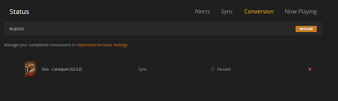

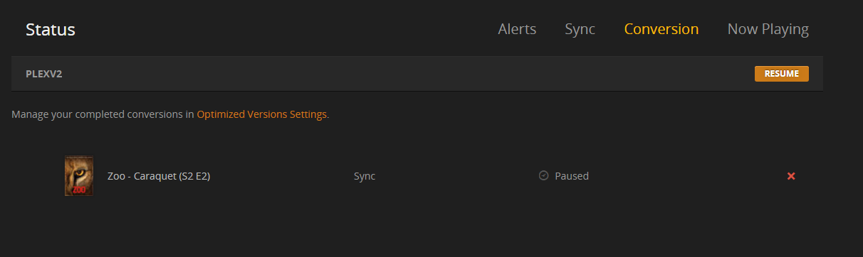

When using Plex Web, you only see the devices for your Admin user. You need to switch over to each user to see their devices. There is a pause option to stop unwanted conversions. Maybe this was turned on for these other users so their syncing won’t progress any further.
This is what it would look like if paused.

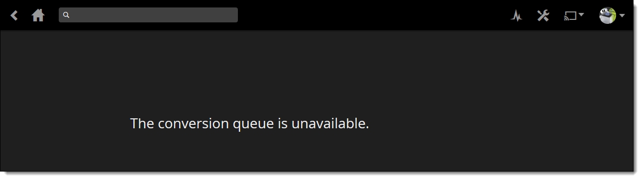

but on the conversion tab:
The conversion queue is unavailable.
Is this an issue here?

I was trying out some things and was able to reproduce the problem. I got the sync jobs piling up all waiting for the server. The conversion tab would show it was unavailable. Clearing out the jobs and creating new ones didn’t help.
For me, turns out that my admin account had the conversion process paused. I added a new sync job to my admin account and the conversion tab showed up and was paused. Hit resume, deleted the sync jobs. Switched to a managed user and the sync job started right up. Try this and see if this helps.
In the mean time, I’m going to verify if that pause option is a server setting and not a user setting.
