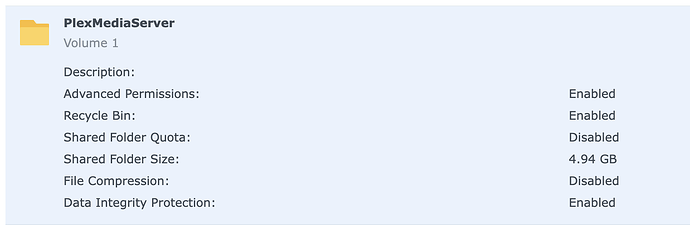

I believe the old and new folders are there but in the file station I no longer see any files or sub folders of my media
I’ve checked all the permissions on this new folder are selected. Is there a way to force migration - I just don’t see anything happening.

From what you show me, It looks like your server did migrate to DSM 7.
Can you look in PlexMediaServer / AppData / Plex Media Server.
You should see all the familiar folders.

If this is the case, then all we need to do is get your ownership back and grant permissions for the new Plex username to see your media.
This is GREAT news. You didn’t lose anything.
Thank you.
Moving to DSM 7 , we were forced to change the username from “Plex” to “PlexMediaServer”
To fix the permissions for your files is easiest in FileStation.
Here’s the FAQ /How-TO
After changing the permissions,
PMS should start to refresh automatically.
If it doesn’t, Manually refresh.
Let me know what impact this has.

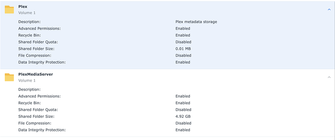

i’m glad you seem optimistic but I’m still not seeing the files migrate or appear. I’ve updated the permissions again. I hit refresh and still not files or sub folders for plex appear.
Any suggestions what to try next?

in File Station if you right click the share the videos are supposed to be in and hit properties whats the file size? That should tell you if you deleted the files or not (and if the folder is big its just a permission problem)

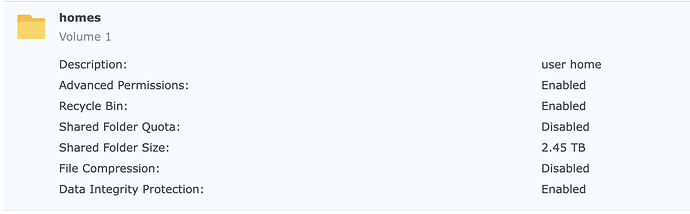

Thanks - yes unfortunately in Filestation does not show any files or the file sizes are very small - no where near the 2 TB of video that was present. However when when I go to Shared Folder - plex doesn’t show the files but my main parent folder shows 2.4 TB however I can’t locate where these might be right now.

Are you logged into DSM with an account? Can you browse the homes directory (user directory)
By what you are showing me and telling me it kinda looks like your Plex share is gone or may have somehow moved to your homes folder/share under a user maybe.
I’ve searched everywhere on the dsm and don’t see any kind of directory or any file names. However in storage it does show what appears to be the files saved somewhere because the 2.5 TB reflects what is missing.
Do you have any familiarity with terminal? If you are logging in with a admin account to DSM you should be able to browse everything in file station regardless of where it is saved.
As @johnblaze00 mentions, you must login to DSM using the admin account or an account with administrator privileges.
The account must have admin privileges to see the /homes (not /home) directory.
Based on your earlier screenshots, which show home, but not homes, you are using a regular user account, not one with admin rights.
Your media files are most likely in the homes directory, but you cannot see them because your are using a login without admin rights.
Login to DSM using an account with admin rights and you will be able to see /homes and find your media files.
