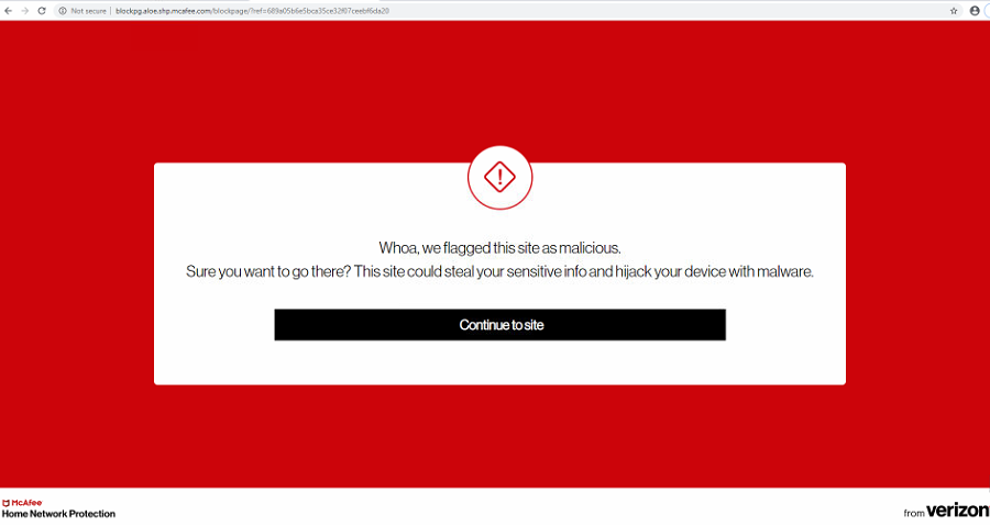

the trouble i am having is at my parents house. when i log in to plex.tv from my parents computer, i get an error that the connection to the server is not secure. “unable to connect to XYZ securely”.
reading this - https://support.plex.tv/articles/206225077-how-to-use-secure-server-connections/ led me to the section about DNS, so i tried changing that.
changing the DNS settings on the windows PC to use 8.8.8.8/8.8.4.4. flush dns cache, and boom! it works!
but i don’t want to have to make this change on every device (this PC, multiple phones, and multiple rokus). I tried changing the DNS settings on the verizon router, the steps are outlined here - https://www.howtogeek.com/howto/38869/how-to-setup-your-verizon-fios-router-with-opendns-or-google-dns/.
and… it doesn’t work anymore? why would it stop working if the DNS request is going through the router, even if it is going to the same destination?
doing an nslookup with each configuration doing a lookup of plex.tv yields the same set of 3 ip addresses. it sounds like there is some kind of DNS proxy thing going on with the router??? how can i tell?
