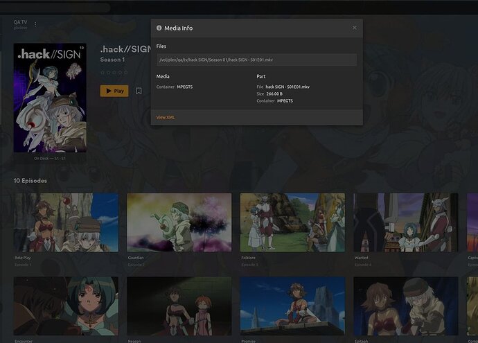

Can you be specific on how you have your files named/organized. It seems fine to me. ( I just have 4 test files per season)
To add to BigWheel,
I just created a test series.
  1. No punctuation in the name . Kept it as hack SIGN
  2. Created one season with 10 episodes for simplicity
  3. No additional TVDB identification required
[chuck@lizum hack SIGN.2016]$ pwd
/glock/qa/tv/hack SIGN
[chuck@lizum hack SIGN.2017]$ ls -laR

-rw-r--r-- 1 chuck chuck  266 Jul 24 13:18 hack SIGN - S01E01.mkv
-rw-r--r-- 1 chuck chuck  266 Jul 24 13:18 hack SIGN - S01E02.mkv
-rw-r--r-- 1 chuck chuck  266 Jul 24 13:18 hack SIGN - S01E03.mkv
-rw-r--r-- 1 chuck chuck  266 Jul 24 13:18 hack SIGN - S01E04.mkv
-rw-r--r-- 1 chuck chuck  266 Jul 24 13:18 hack SIGN - S01E05.mkv
-rw-r--r-- 1 chuck chuck  266 Jul 24 13:18 hack SIGN - S01E06.mkv
-rw-r--r-- 1 chuck chuck  266 Jul 24 13:18 hack SIGN - S01E07.mkv
-rw-r--r-- 1 chuck chuck  266 Jul 24 13:18 hack SIGN - S01E08.mkv
-rw-r--r-- 1 chuck chuck  266 Jul 24 13:18 hack SIGN - S01E09.mkv
-rw-r--r-- 1 chuck chuck  266 Jul 24 13:18 hack SIGN - S01E10.mkv
[chuck@lizum hack SIGN.2018]$

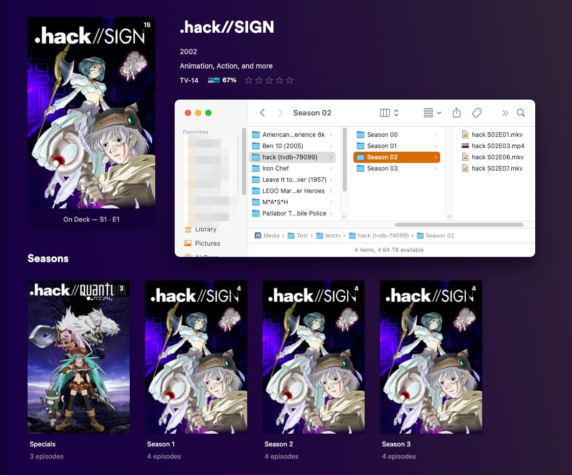

I had it as hack and Season 1 folder etc well organized like all my files as i understand the mantra “garbage in garbage out”. Adding the {tvdb - 79099} to the folder name instead search fixed it. But i think ill try to rename it to hack SIGN and see if it will work

I got your message @Tenrai-Sensei I see what you mean about episode info not coming in for s2 and 3 using TVDB episode ordering. TheMovieDatabase (aired) episode order seems to work for now. I will let metadata team know about TVDB orders not pulling in episode info past season 1
