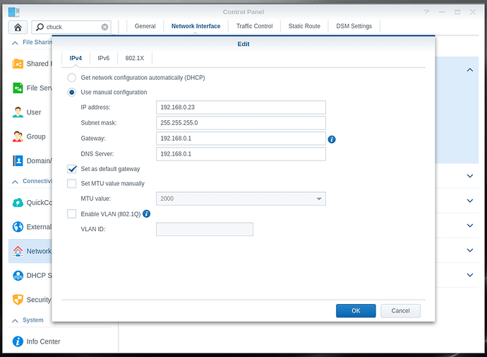

In the Syno. Control Panel - Network - Interfaces - eth0 -
  1. What IP address does it have for default gateway and DNS?
  2. Does it look like mine where the DNS and gateway point to the modem/router ? (except using your LAN addresses)
  3. Lastly is eth0 the default gateway adapter?
  1. Show me please if not?
@trumpy81 thanks for your response. I’ve checked all the cables, and re-seated everything. I don’t think my router has any DNS Rebinding protection. I couldn’t find any references to that.
@ChuckPa Yes. In my router I gave the Synology a manually set IP in the DHCP list. Under Network - Network Interface Lan 1, I have the following:
  • Gateway and DNS: 192.168.50.1 (verified router LAN IP set to this)
  • IP address: 192.168.50.3 (same as it’s manually set in the router)
  • LAN 1 is set to default gateway adapter. Is LAN1 the same as eth0?
Here are new logs. Plex Media Server Logs_2021-09-05_18-00-24.zip (5.1 MB)

  1. eth0 = LAN 1 (eth1 = LAN 2) – That’s how Linux numbering works
  2. I agree with Trumpy, set the DNS manually next. We’ve seen a few cases in the past week were DNS was blocking PMS from working correctly.
