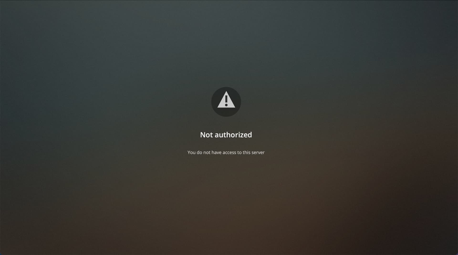

Hi, I recently upgraded my Synology Diskstation to DSM 7. Correspondingly when Plex stopped working I checked the forums and did the uninstall and reinstall of Plex according to the steps detailed by @ChuckPa . After installing, when I try to open the Plex Media Server, I’m greeted with the message Not Authorized. You do not have access to this server. What seems to be the problem, and how can I fix this? If more information from my end would help, please let me know what is needed. Thanks a lot in advance.

Basically I freshly installed Plex on my DiskStation that I just updated to DSM7. There is nothing to migrate. I get a confirmation that the claiming of the server was successful. As I would simply like to start PlexServer, this window appears.

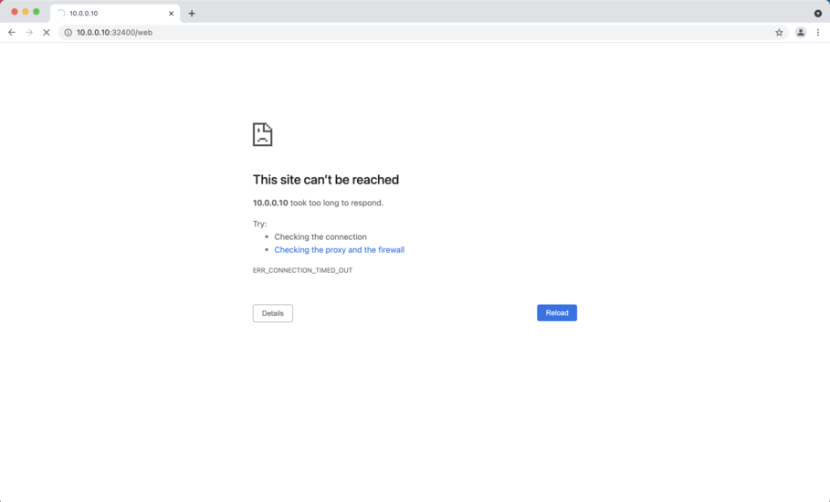

Instead of using the links provided by the DSM GUI look up your NAS IP address in your local network.
Use the link http://192.168.178.x:32400/web/, where x or the whole string has to be replaced accordingly.
It worked for me in Chrome, but I needed to open the link 3 times and let it load - but you will see there is no access denied anymore. Cheers!
Thank you trumpy81 for pointed these things out. I shall keep these suggestions in mind for the next time I am getting in touch on the forum. The 10.0.0.10 address comes from a previous reply to this thread which was just an attempt to fix things. Fact is the DSM link did not work previously, manually looking up the IP address and adapting the link manually worked and now even the DSM link works. Nothing else happened except a few hours of time passing. I failed to read this instruction anywhere when downloading PMS, so maybe it is intuitive for some, but maybe not for others. Interesting first experience with Plex with very quick support though, thank you for that.
Exactly. The IP address comes from a post to this thread 19 days ago, in response to an uploaded log file. So it was not fitting. In an attempt to just follow all the instructions given here in this thread, I also tried this.
Again, you confirmed that the DSM links are not working correctly under certain circumstances. I was not aware of that. This is what caused the issue in the first place. No blaming here in any way, but for noobs like me it would be nice if this would be pointed out more clearly. But please, not sure where we went wrong. I am appreciative of your quick responses and how that led me to dig a little deeper into the issue - and now PMS works beautifully. Cheers.

I think I’ve followed what was directed, but this is my first day with a Synology device and with Plex. When I try to go to setup after install, I am also getting the “You are not Authorized” message. When I look in the server log file, it tells me that the request came in with unrecognizable domain.

When I hit open on the Plex - I am navigated here - http://40.40.40.20:32400/web/index.html#!/setup/86061dc0c0630418a0f1c34500d1caafd0fabad0, then I get the not authorize message, which I am sure you are by now familiar with.
I have already signed out and unclaim the server, then install with Plex token…I get the same issue…I have attached my Logs.zip (4.8 KB), so hopefully you are able to assist me.
