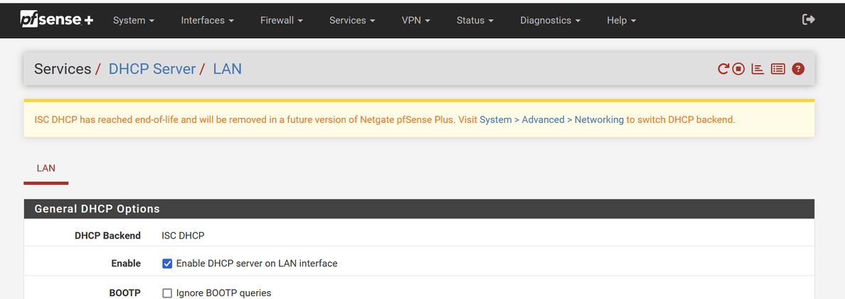

Maybe so, but the problem is that Netgate didn’t clearly notify users who received the update that KEA was a preview. Instead, we were shown a warning in red like this anytime the DHCP server page was opened, which happens when one wants to edit DHCP reservations :
Even clicking the “?” for help at the top leads to a page that does not mention anything about ISC or KEA.
Following the suggested link shows this :
Notice how there is not one word about how KEA is a preview.
And the “?” at the top of this page does not lead to a page mentioning ISC vs KEA either.
There were indeed 2 places I could have learned about it.
