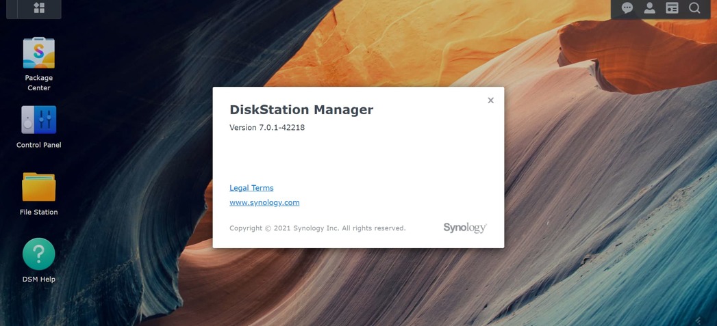

This may be a stupid question but how do I uninstall DSM? I am accessing the web version, so I may not have installed anything on my PC
Your Synology is running DSM 7, correct?
If so, uninstall Plex Media Server (not DSM 7) from the NAS using the Synology Package Manager. Then proceed with the rest of the steps.

I don’t see any migration log file. I suspect this is not the Plex folder you are referring to as I created this one, not the system.
Let me know if I am looking at the right things based on the screenshot I’ve provided. I am keen to start from scratch to get Plex back on track.
