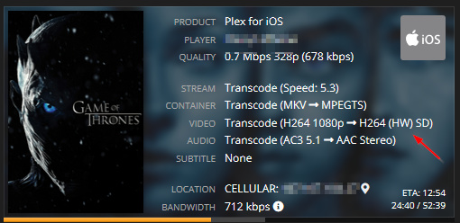

I turned off HW Acceleration, as you suggested, and it worked. I then turned it back on and it’s working normally again enabled. This is running on an i7 NUC and has always supported HW-A from the first inclusion in beta.
Here’s a shot of Tautulli with the HW flag enabled playing remotely right now:
After a reboot with HW-A turned on, it failed again, then turning it off and back on again, it worked. I’m not sure if this is some domino effect going on but it currently appears that the way to work around it is to literally “try turning it off and on again” for HW-A. That’s messed up.
