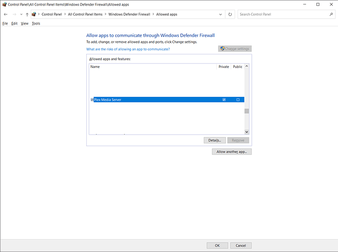

Don’t do that, that won’t work. Just check to see if Plex Media Server is open.

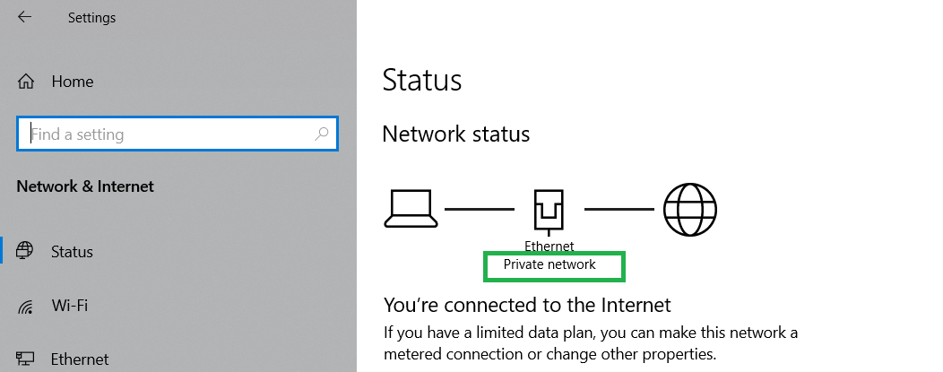

Another thing to check is if your network connection has changed from Private to Public. It should be Private.
Plex media server is open and works perfectly on my local network. The only thing that don’t work is my remote acces. My connection hasn’t changed, it is still private because it is on my computer at home.
I mean open in the firewall.
I mean this.
Yes I know. It is open on my firewall and my network is on private.
