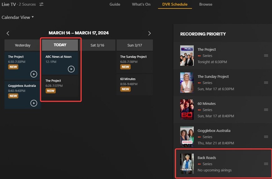

Here are some screenshot as an example:
In this first screenshot I’ve just setup a DVR schedule for the show “Back Roads” to record the series.
Then when I check the DVR Schedule tab, I can see it in the list of shows set to record on the right side of the page, but it shows no upcoming airings even though I started the process from an episode due to air in around 2 hours time.
