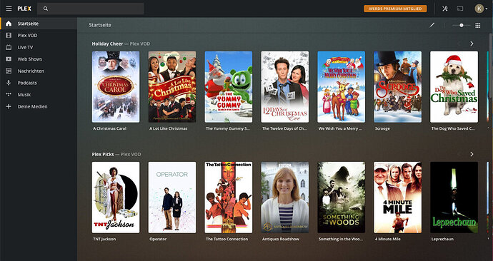

I’m trying to setup the Pley Media Server on my MyCloudEX2Ultra. It will take me to the local web interface, but won’t show my NAS on there, I get the default page look.
I’ve tried to do all the steps I found on here, deleting .plist and logging off and on. Nothing helps. But the NAS is available, on the AppleTV I can see the device, but also a connection error.

Yes, I do. I can access the web interface, by clicking the configure button on the apps tab on my MyCloud interface.
When I log in it shows my local IP address and asks if I’m sure I wanna connect to this non verified address.
And then I get the page above in the screenshot.

You mentioned you’re trying to setup the Plex Media Server vs. you can see the server in your other clients (even if it’s not accessible). Did you previously complete the setup of your PMS?!
Based on your symptoms it appears the server is linked to a different Plex account. Is that a possible root cause for this issue?
