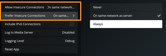

And you have both of these settings set to Always ?

All working now, looks like it was my powerline adapters. I took them out of secure mode and it all works fine…really odd…
