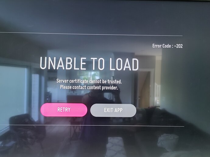

LG Smart TV App - "Server certificate cannot be trusted" SOLVED
Server Version#: 1.23.4.4805
For the last number of days, I have been unable to open the Plex app on my LG TV. I can still access my server from all other sources, but the app on the TV is non-functional. There have been no recent updates prior to this problem.
Steps I have taken so far:
Rebooted all network routers/modems
Rebooted Plex server PC
Factory reset LG TV and reinstalled Plex app
Used both DHPC and manual IP settings on LG TV
I get the same error message every time
Error code: -202
UNABLE TO LOAD
Please contact content provider
Can anyone help me?

After reinstalling, I don’t even get to a sign-in page. It shows the Plex logo, then just shows the error screen. The app simply refuses to run on this TV now. The TV was in my list of authorized devices, as a trouble-shooting step, I removed it to force a “relink”, but it made no difference. The app won’t even get that far before the certificate error shuts it down.

I’ve already turned off IPv6 and used 1.1.1.1 as a DNS, neither of those has made any difference. I will try that in combination with unplugging the TV when I get home and see if it makes a difference. It’s getting super frustrating as we all love using Plex and feel totally crippled when it doesn’t work LOL
Can you check that the system time/date on the TV is correct. We have tried to repro on WebOS4 Tv and cannot figure out why it would be giving error.
Still no success… did another factory reset, unplugged the TV for over a minute , manually set IP address using 8.8.8.8 as the DNS, confirmed date and time are all correct. Tried connecting over WiFi and hardline, no difference. The Plex app that is available on the LG store is version 5.0.1
