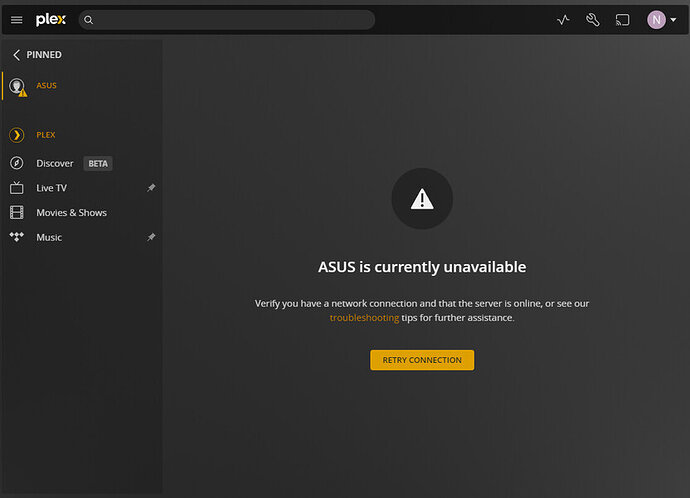

Can't reach server using "https://app.plex.tv/desktop/#!/" since password reset
Since password reset, I can reach (and have reclaimed) server from everything else (Roku, Plex Windows App), including local IP address via browser, but I cannot reach server using “https://app.plex.tv/desktop/#!/”

I have signed into WebApp and it does not connect to my Server. I was lucky and got a copy connected once two hours agao, but accidentally hit back and it is gone
What do I do?
Or is this related to ongoing issue still?
Thank you

I have the same issue.
Did a p/w reset with the sign out all devices options
Reclaimed my PMS and also getting the “app.plex.tv unable to connect securely”
I tried a bunch of stuff but to no avail.
Looking at the PMS logs seems to show an issue in getting the SSL certificate.

Is yours working remotely?
I have managed to get one local logon working. Same browser it will not connect in a different window.
It doesn’t work remotely yet only locally.
What was the fix?
I figured out how to get logged on web browser only locally. Open the Server in web by opening from the PLEX Server icon in the windows bar.
Tested it 3 times in a row… Again Only Locally on the machine running PLEX.
Yes, I have that working too, but not from:
My local server doesn’t work nor does the remote server. I hope they rlease a patch soon when I go to my localip:32400 I get ERR_CONNECTION_CLOSED
And online I get nothing
I’m running on a QNAP device
