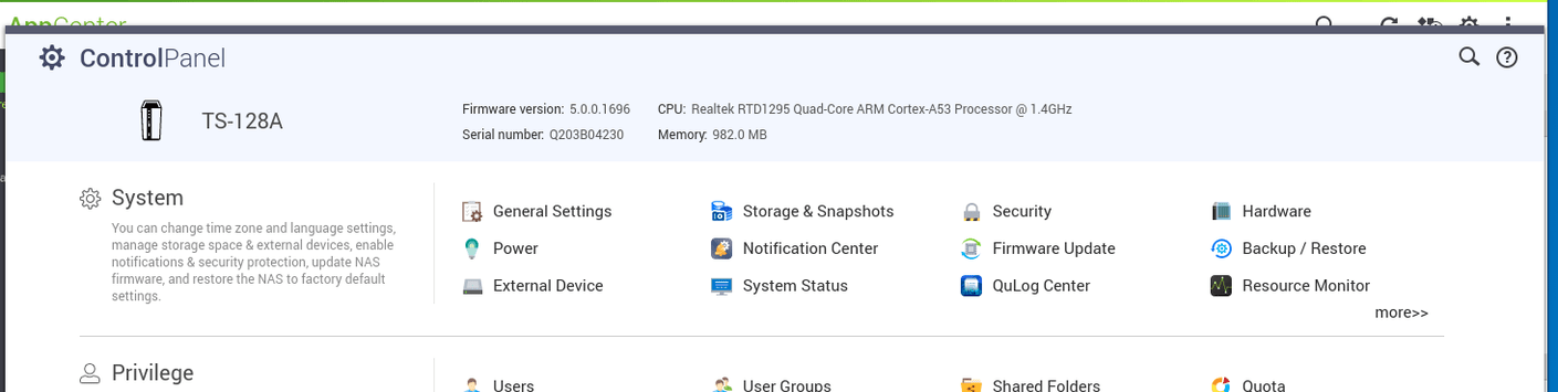

  1. I have it running on a TS128A without issue
  2. Clearly issues are on a per-model basis.
