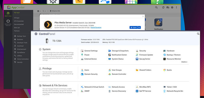

Checked the Plex Pass download.
QTS 5.0 installation works.
Please see below.

Im runnng QTS5 and am getting the same unable to install for the latest PMS (PlexMediaServer-1.23.6.4881-e2e58f321-x86_64) And have done so for the last three upgrades of PMS. I can’t work out what the fix is from this thread. Is it to go back to QTS4.5? If so, how do I do that? Thanks for your support. Steve
It is safe to go back to QTS 4.5.
To do so.
  1. Download the correct firmware for the machine.
  2. Perform a Manual Firmware Update
  3. It will warn you
  4. It will also tell you it’s not supported.
  5. Let it complete without interrupting
  6. Restart when complete
  7. reload any apps which need it. (I did not need any)
Thank you so much. Nice and clear. Im not sure where I am getting the firmware from to do this (must be from QNAP), and how I know I’m downloading the right version to get back to QTS4.5. Steve
Thanks so much. Back to 4.5, and the new PMS working well. My older Samsung TV has Plex installed, and since going to 5.0 that app has not been working. So Im wondering whether it will again now. Best, Steve
