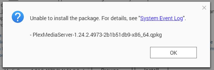

Not expecting a fix as I understand 5.0 is beta; but I’m actually getting the same issue as @DarrOlson . Tried the previous package (Attached above) and also latest through the web prompt with the same result. It’s not a huge deal for me as it still works with the older version but not sure the reason. I didn’t try to nuke it and reinstall Plex again as everything still works but might be an option for some.
@dellybelly
What does QTS show in System Event Log ?
That would help me a great deal.
I installed 1.24.2 without issue.
The same scripting runs for each different binary (X86_64, ARMv7, ARMv8, etc) If it builds for one, it builds for all. That’s how we built the packaging system.
Thats the weird part; doesn’t really give me much; unless theres other places to look?

Actually got to like 46% then gave the same message; looking at the icon in the back it switches from “Updating” with a quarter pie then goes back to nothing then back again. Does this maybe 5 times before failing, going to keep messing around.
If I run it from SSH and turn on my admin account I get this:
If I do it with my user account I get “Permission Denied” on a bunch of folders; although I don’t recall which account I’ve used in the past to update as admin is disabled generally. Going to visit perms I guess.

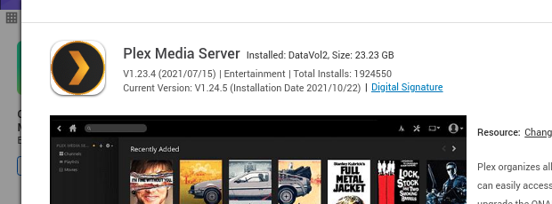

Hi all! Got exactly the same issue, cant updated PMS to new version, currently running 1.23.4 from app center (

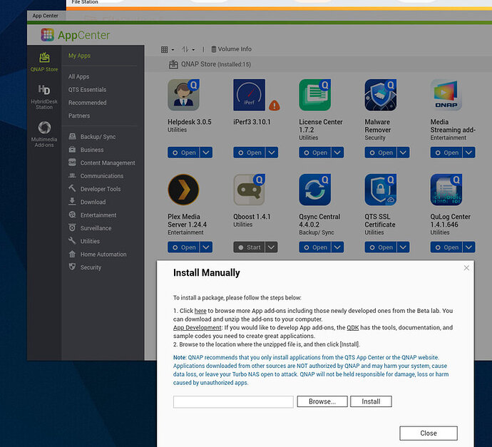

you can explain exactly how to edit /etc/config/qpkg.conf
App Center - Install Manually - Browse to QPKG file - select it - Install – Close when done.
