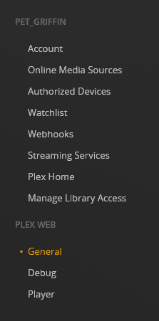

I am running PLEX server on a QNAP and had no issues until I tried to access Plex on my iPhone yesterday and couldn’t find any libraries. I opened Plex web from the QNAP and can’t see any libraries there either (only have music installed BTW). When I click on the settings icon on the RHS on the webpage (running Firefox), I don’t the SETTINGS/MANAGE etc headings on the LHS of the webpage. Here is a screenshot:
I am just baffled about what is going on … I see the same webpage in Chrome so am wondering if there is an issue with the Plex set-up on QNAP? Couldn’t see any options there other than to remove and reinstall Plex. All suggestions gratefully received - thanks!

Hi
not sure … I checked here to see how to reclaim a server:
How to Claim Your Plex Server - Plexopedia but I don’t see the “claim server” button on the Plex web page. Here is a screenshot of my “General” window
I did set two factor authorization for Plex (I think it was on the QNAP) but I never seem to need this for Plex web.
