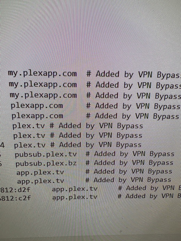

Check if your windows host file has an entry for Plex.tv (it shouldn’t).
It has three
Remove all of those. Those are blocking all Plex domains.
Just the Plex.tv ones? And then save it?
Oh my god, I could kiss you! Thank you so much, I never would’ve figured that out on my own, you’re the best!
No, you should remove all of those entries.

oh ok, so that notepad should just be blank? (sorry for the stupid question)

Maybe SwiftPanda has more info for you, mine is working now that I’ve cleared those host files.
