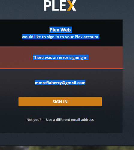

Installed Plex Media Server but I still have this sign loop
Plex Web
would like to sign in to your Plex account
There was an error signing in
Not you? —

Which web browser are you using?
Are you using any browser add-ons like LastPass or AdBlock or …?
I am using Chrome.
I have AdBlock but I have it “turned off” for Plex
Any 3rd party firewalls or anti virus software?
Particularly if these try to scan encrypted network packets, they render the packets invalid by doing so.
Have you verified that your computer’s clock/date is correctly set? Otherwise a lot of network communication will fail.
I have done all that, after reading other posts etc.
As i have said, i have no problems logging in to my Cloud Plex server but It won’t let me sign into my local PMS
Can you remember moving the Plex data folder to a different location, back then when you installed Plex server locally the first time?
Is your Windows system volume on a different drive letter than C: ?
You could try the ‘nuclear option’:
https://support.plex.tv/articles/201941078-uninstall-plex-media-server/
Have you seen this page?
https://support.plex.tv/articles/203841316-plex-media-server-can-t-sign-in-to-plex-account-or-be-claimed/

Otto,
I have uninstalled my PMS and deleted the Registry key & also deleted the Local app data.
I then rebooted my laptop and re-installed PMS
It seemed to take a long time to load (took me 3/4 times to get it too load)
It opens with this web page “http://127.0.0.1:32400/web/index.html
It opens on the login page
When I try to log in, i get the login loop again
I don’t get any other error messages only is thsi
I am at a loss at what to do next
And then this
