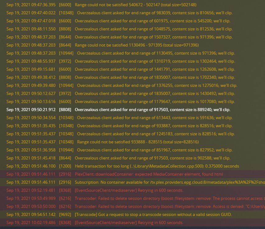

Here’s a screenshot of my warnings/errors from the console during playback and when it stopped abruptly. Are others seeing similar?
