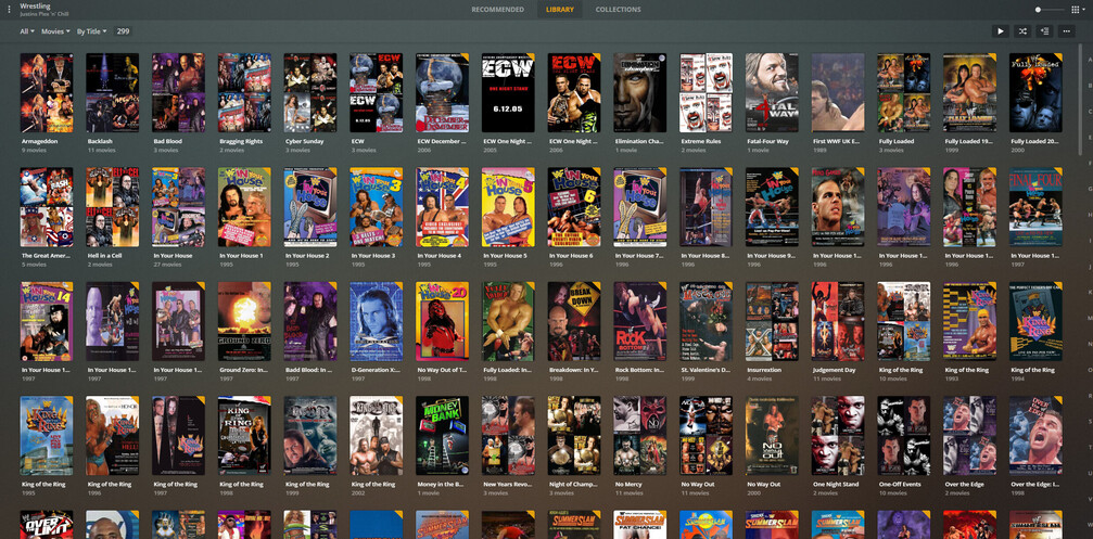

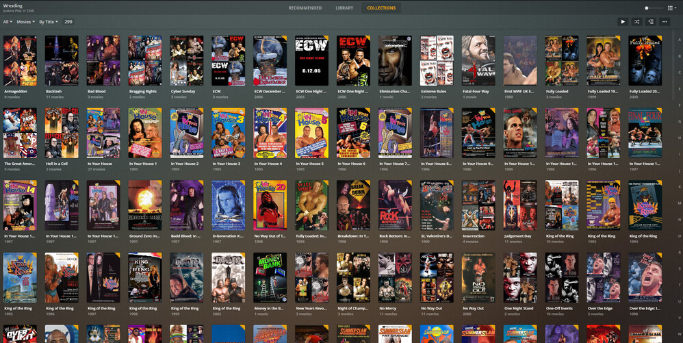

My library and collections are showing the EXACT same thing. Meaning, my library is acting as it should, but my collections is an exact mirror of my library, even the filters.

Library
Collections
I tried mimicking my movie library where the collections are fine, but only seems to happen in this library.

Is this just a bug? Because I don’t use automatic collections. I have it disabled. I think you’re misunderstanding my situation here. Those aren’t 1 movie collections. Look at the collections page, it’s EXACTLY how the library is supposed to look.
I had this exact issue, and the only fix was to go to Plex Web > Settings > Debug > Restore Defaults, which resets all your Plex web settings. Hopefully that isn’t too disruptive, your media and server settings should stay the same I believe.

edit: Worked perfect!! Thank you!
I had the very same problem which occurred yesterday. Using Plex for Mac, the Collections tab show the exact view as my Library tab. Using the Plex web interface though, the Collection tab wasn’t affected; so I assumed it must be a Plex for Mac bug. It just happened out of the blue.
Thanks for your suggestion, it solved the problem. The Collections tab was restored to as before, and all my settings were kept.
