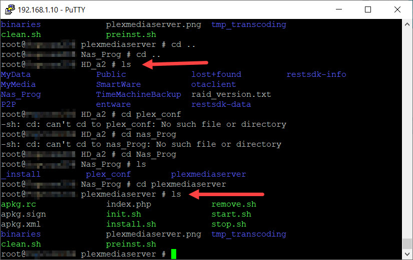

I’m still unable to upgrade my plex server, but it is working. Should I remove the folders and files shown below and re-install or use the Plex app Uninstall option in the web gui to my pr4100? or both?
SSH connection using Putty.
/mnt/HD/HD_a2/plex_conf doesn’t exist
/mnt/HD/HD_a2/Nas_Prog/plexmediaserver exists and has multiple files.
@rlevy795 You could try uninstalling Plex Media Server from the WD Web UI then removing any left overs via SSH like so;
rm -rf /mnt/HD/HD_a2/Nas_Prog/plexmediaserver
Then download the latest Plex Media Server release from https://www.plex.tv/media-server-downloads/ (ensuring you choose the Western Digital platform, and your downloaded file ends in _OS5.bin) And installing it on the device.
This should setup the server and if your existing plex_conf exists in /mnt/HD/HD_a2/.systemfile/OS3_Apps_Backup/Nas_Prog/plex_conf we will migrate it over.
