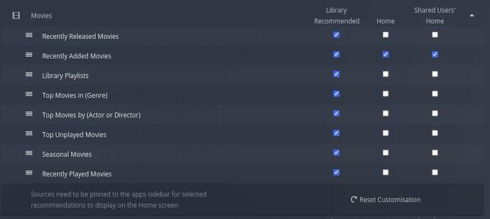

Do you know if this only happens for you on the shield or if it happens on other clients also (web for example). If its only happening on the shield have you tried clearing the plex apps cache and data along with a full reset of all customizations within the app itself. If its also happening via the web client you could also try and reset customizations from within your libraries. This is done via the settings on your plex server.
May or may not help but said I’d mention it in case it does.
