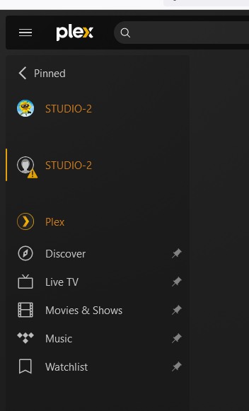

I upgraded my Win10 to Win11 with the option to reset all Apps but keep personal data.
I reinstalled Plex, but I now have 2 instances of my server, and one of them is corrupted and
causing the server to Not work. Please see 2 screen grabs.
The server was installed with the latest version from Plex downloads,
PlexMediaServer-1.40.3.8555-fef15d30c-x86_64
Server Version#: Version 4.132.3
Your second screenshot is the place where you can remove the old server instance from your account.
Just move your mouse pointer over the badges.
Be careful to remove only the older server there.
