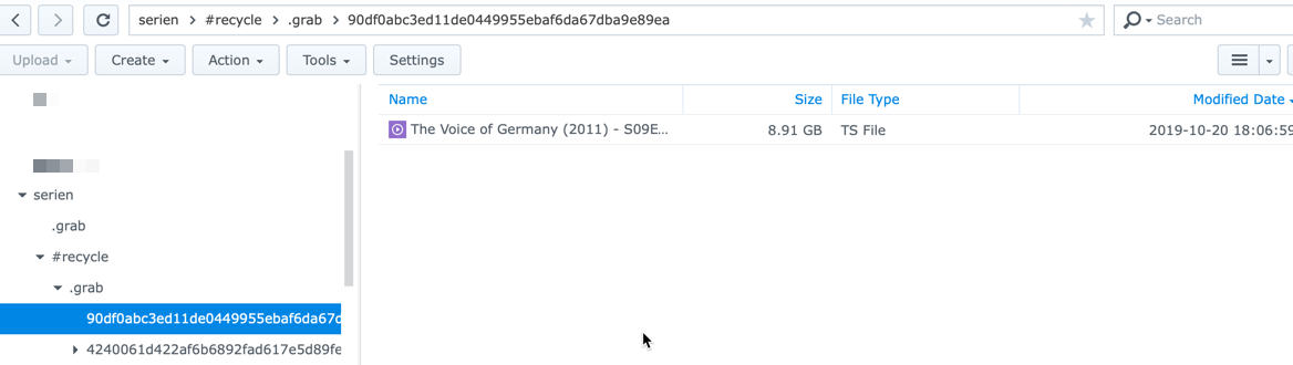

I do, and very soon after the recording starts, the file moves from the .grab folder in the destination to the .grab folder in the #recycle location. The file continues to grow and in fact is OK once the plex stops recording, but I have to manually move it since plex doesn’t know that the file moved. It’s almost as if plex did something to trigger the OS to recycle the file while recording, but because plex still has an open handle on the file it continues to write to it.

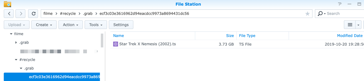

Oct 20, 2019 00:17:00.287 [0x7fec24855700] ERROR - DVR:Grabber: Failed to inspect file: Could not parse /volume2/filme/.grab/50fc96b37ff5c037b4d5ceda04ddc4096d25b577/Star Trek X Nemesis (2002).ts (error=-2): No such file or directory
Oct 20, 2019 00:17:00.301 [0x7fec26e6b700] DEBUG - DVR:Grabber: Operation for 'Star Trek X: Nemesis (2002)' on channel 118 completed with status error (Could not move recorded media to destination)

Update: I enabled the recycle bin again. It seems, that the media in the .grab Folder was moved to the recycle bin, before it was moved to the right Position on my movies/tv Shows Folder.
When the recycle bin is activated, i can move the media from the recycle bin manually.

One thing to note is that if you watch the files during recording they will be in the main .grab folder for a while, then after a few minutes they magically move to the #recycle bin’s .grab folder and then continue to grow as plex appends more and more data to it. That leads me to believe I have the correct permissions since the recording starts out correctly, and that something is triggering the move during recording.
