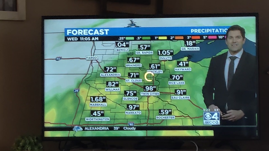

I’m not sure if these two issues are related or not, but after about 10-15 minutes, I received this error message:
If I go back to the guide, and select the same program (watching live), it will run fine again for about the same time period, then it starts stuttering, (or is it buffering?), every few seconds.
Eventually it will give me the above error message. I have tried this on two different FireTV clients. One on wifi, the other Hard Wired. It does not seem to happen on the web browser, however, that is on the localhost.
Plex Media Server Logs_2021-03-23_10-27-18.zip (6.3 MB)
I have checked the signal, and I am getting 100% on the HDHomeRun Quatro. I get no buffering or other issues using the HDHomeRun app on either FireTV.
