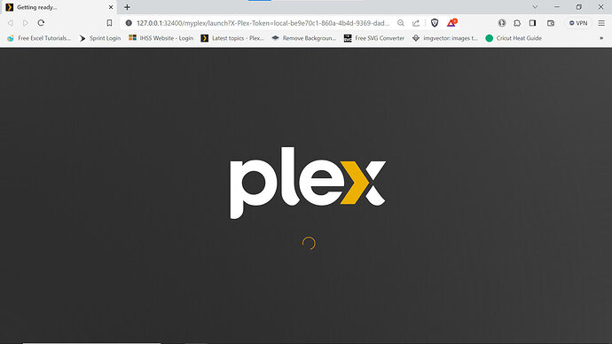

I’ll start by saying I’m no expert using plex. I downloaded the server a few years ago, and haven’t had a problem with it until now. A month ago there was an update available, I downloaded and began the updated as normal, but there was a problem and a message came up saying I should manually install the update. After it was all done, I got a message saying I needed to claim my server, but it wasn’t letting me. I followed the steps in other forums with the same problems, but nothing worked, I finally ended up uninstalling and deleting all plex files so I could start fresh. Now when I launch the server, it’s stuck loading with the plex logo on the screen.

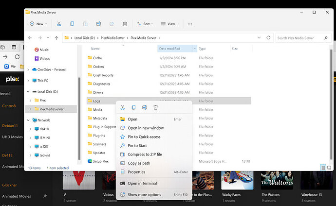

Can you please restart plex. wait 2 minutes, try to open it, Let it spin a minute, then stop it.
IF I understand Windows correctly
In your %AppData%\Local you’ll find Plex Media Server. Under it, you’ll find “Logs”.
Please make a ZIP of the Logs folder and attach it here for me.
I have PMS on my Drive D in a custom location so mine looks different

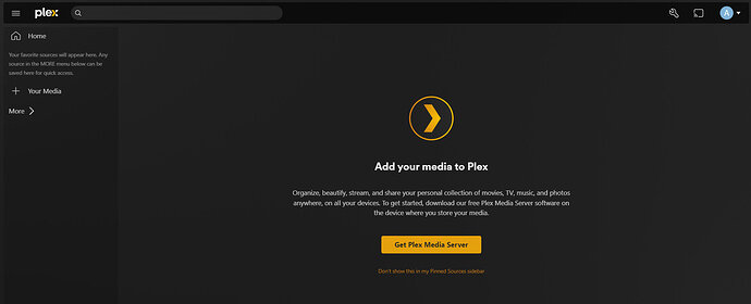

So since my original post, my screen is no longer stuck on loading. Now it just keeps telling me I need to download the server despite having it already.
